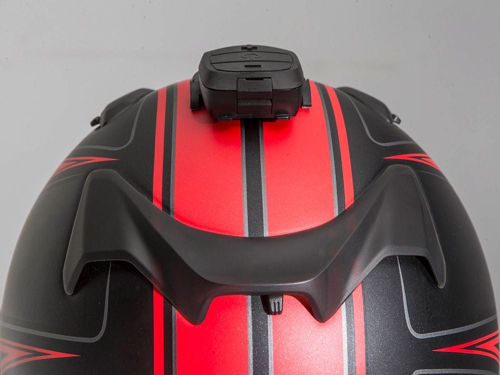

check this out :) turn your whole helmet into a speaker :D
Yeah, I saw that a few months ago. Unfortunately, the general consensus I've read is it's useless for any riding over like 35 mph. It's just vibrating the outer helmet shell. There's still the liner foam between it your head. Wholly inefficient way of getting the sound to your inner ear.
When I messed with the Aeropex under the helmet it was quite the opposite. With earplugs in and my helmet in 70 mph windblast it was totally listenable at just over mid volume. But that's understandable as the transducers are pinching my skull. Not sitting on the outside of my helmet with 3/4" of foam in the way.
Cardo, Shoei, somebody just needs to integrate small transducers into a helmet liner with adjustable position and tension. I don't see any reason why this couldn't be accomplished.
