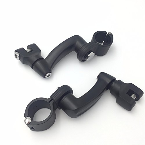

I'm thinking these brackets may move the pegs back far enough that I can get my leg underneath the tip over wings. Maybe allowing the mounting high enough to not have concerns about cornering.
http://ecx.images-amazon.com/images/I/41EykPhF9xL.jpg
