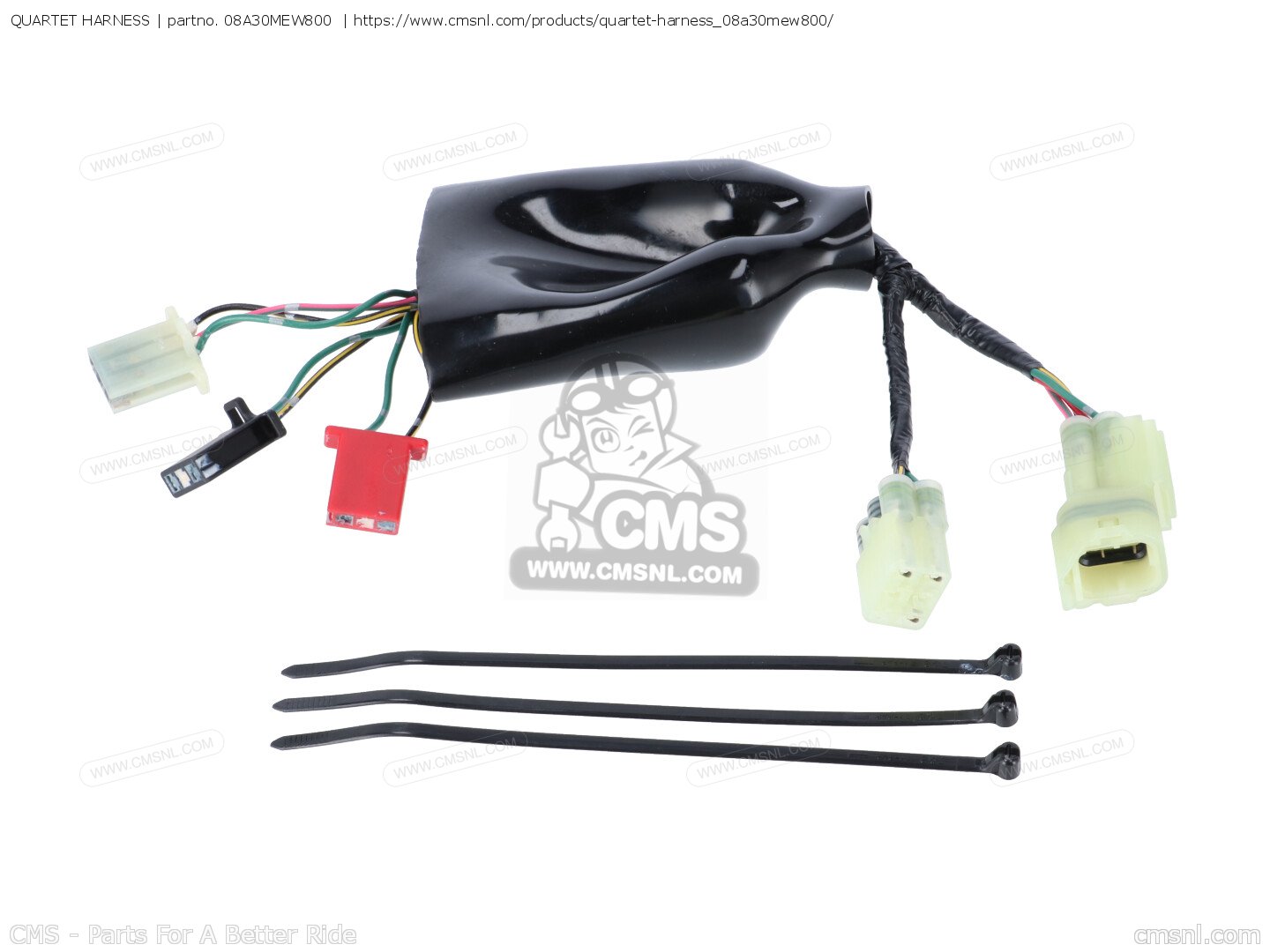

It has a power outlet hard wired to the battery. While the tupperware is off, I'm thinking about tapping into the switched power in the left lockable cubby. Not married to that idea either. Having real trouble getting the weatherized cap off of the four wire lead. Can't tell if I'm supposed to push in or pull up on the tab when trying to pull the connection off.
