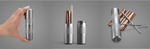

I see a spiral leak path opportunity for air and sometimes punctures are at odd angles or crazy sized. I'll stick with rope plugs. I have these compact kits on the bikes. A strip of plugs + reamer/inserter all fit inside the handle.
