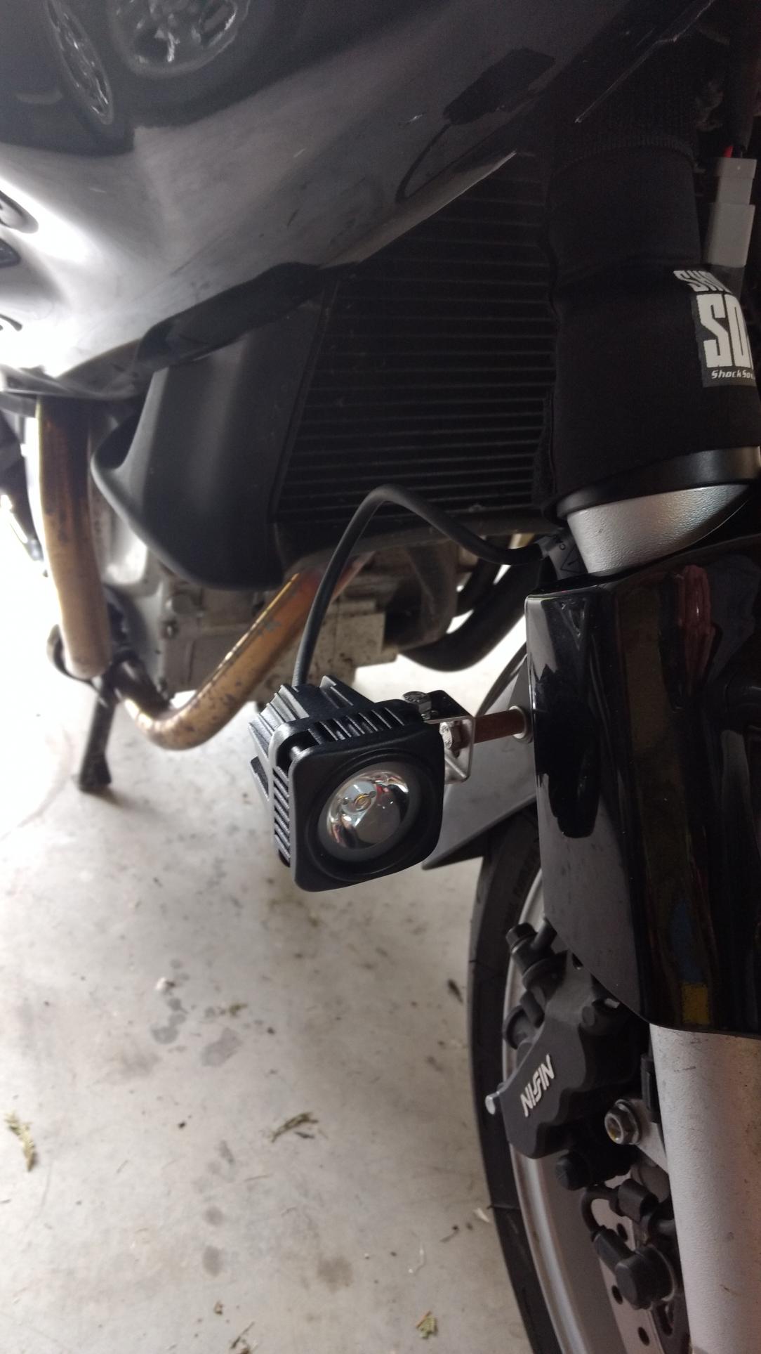

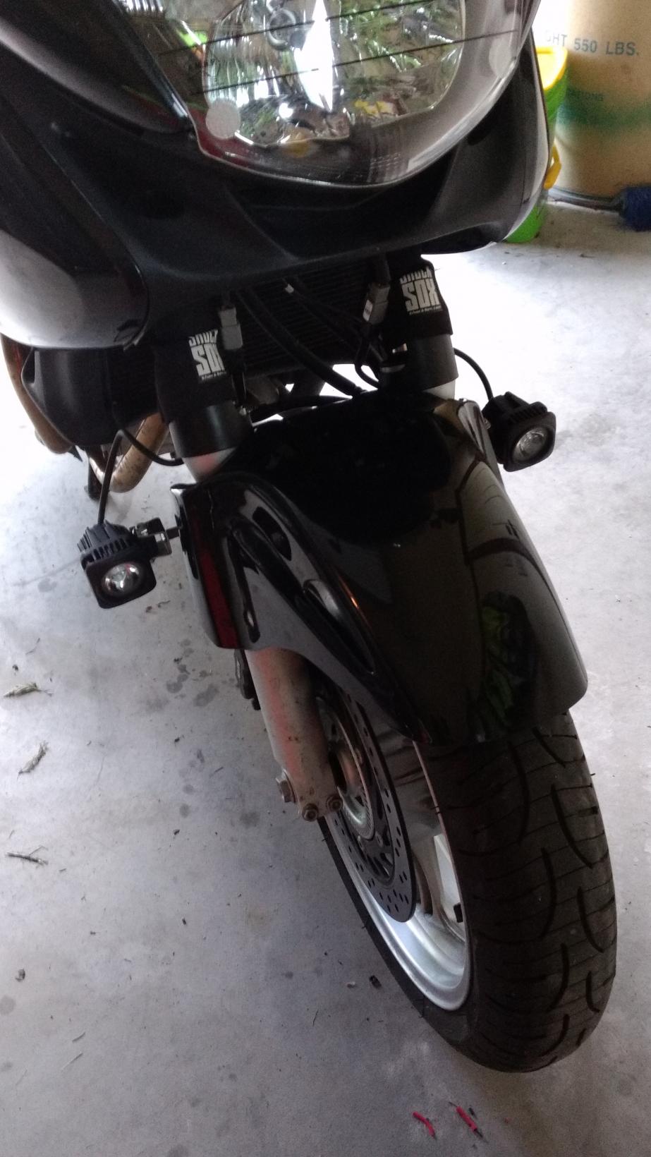

Saturday I installed a couple of 900 lumens auxiliary lights from Superbrightleds.com. Not a bad price at $34.95 each.

I'm just asking out of curiosity; don't those lights get the bejeezus shaken out of them being mounted that way?

First I purchased the Shock Sox on Amazon.com.
Second the lights should be fine. I had some 700 lumen lights mounted in the same location and they did just fine.

Mine have been mounted that way for about 114,000 miles. There's nothing much to be shaken in an LED light. They don't have filaments.

looks like you mounted on reflector bracket, by taking off bracket? do those stand-offs come with lights? i think its about time i add some
Not sure if this answers your question but, I used a longer bolt and covered the exposed threads to some aluminum spacer. Everything else came with the lights.

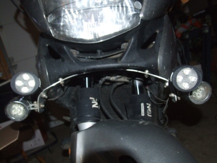

FINALLY added the lights. got 30 beam. nice! now I can see better with all those 2 + 2 lights coming at me(all these newer vehicles with normal headlights and driving lights). with my brights on it fills center real well

I mounted lights by taking off reflector and mounting thru that hole of bracket that holds brake hoses. First week in Dec, right side bracket broke. So ordered new ones, then welded gussets in corners to prevent anymore breaking.
