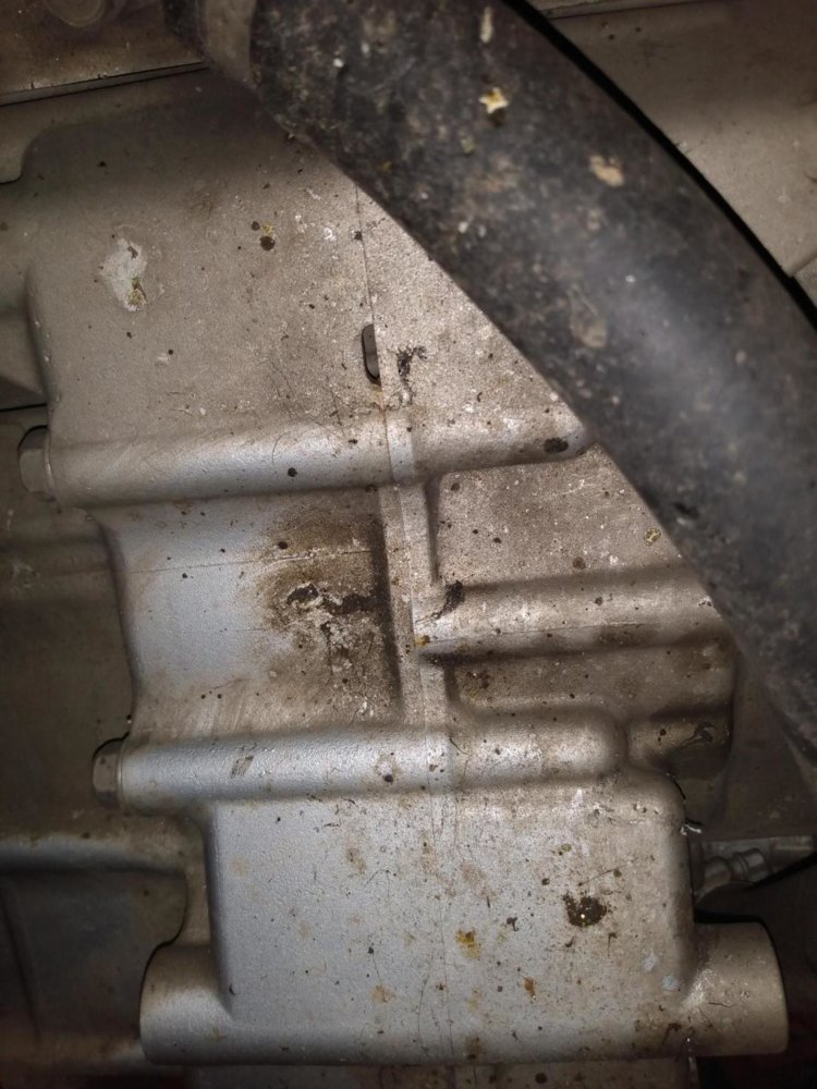

I purchased my 2010 NT700 at the beginning of June with just under 7000 mi. It currently has 8500 mi. Getting
set up to do my 8000 mi. maintenance. Notice some oil seepage at the front of the engine casing. (see picture).
Thought I got a fair price on the bike ($3600). Now I'm starting to worry I was sold a problem. How worried should
I be? Thanks in advance.
These notches shown in the picture are pry points, with the engine removed and all the bolts out, you would pry in these notches to break the RTV seal between the case halves.
Manufacturers like Honda put these notches outside the oil exposed area of the engine, so in actual practice a leak out of one of these would mean the leak is farther in on the case halves. The leak would most likely be a void in the RTV. Notice how the notches are near the engine mounting bosses, there's another wall of aluminum that separates these notches from the actual engine's insides.
I can't imagine why someone would have the case halves apart on the NT, this engine is so reliable it's ridiculous. Notice how the top pry point in the picture looks used the metal in the slot is deformed? It would not come from the factory like that. If the front VC gasket isn't it, I'm not sure what to say.

I feel confident that it was the VC gasket. Performed my valve inspection at 9500 mi. Currently at 11,300 with no leaking. Don't know what to say about the pry point, except that I acquired shop records from Honda shop the previous owner frequented and there was no mention of engine work.
It would be extremely unusual for someone or a shop need to split the crankcases on a NT700V.
