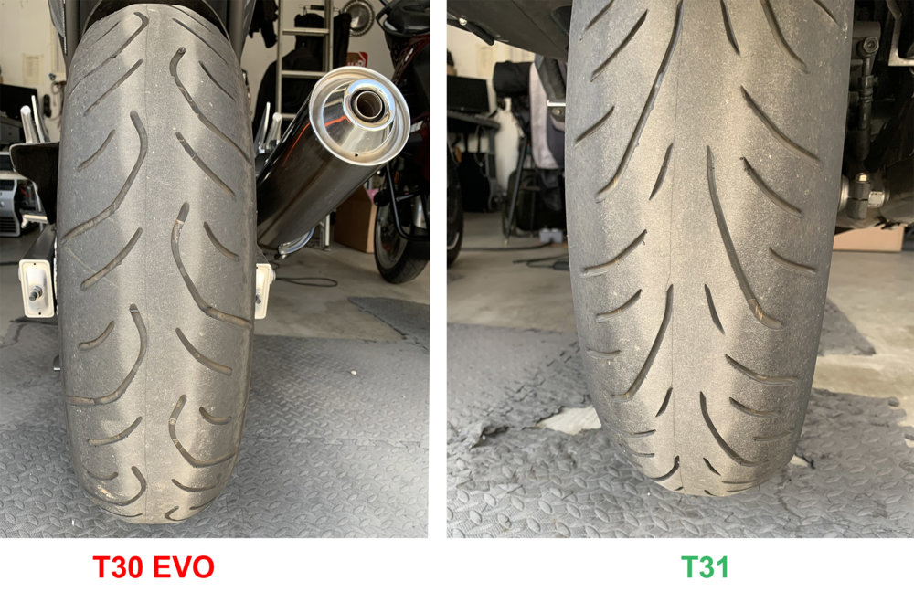

Your statement was true about the T30 EVOs. The successor T31 has improved wet traction, per the statements from the Bridgestone Rep I spoke to at the 2018 IMS at Long Beach Show.
The 150/70-17 is a rare bird indeed. When I got the last T30 EVO for NaTalie, I was told it was the last one in all of the US warehouses. Since then I have migrated to the T31s. NaNCy, My NC700X is due for a rear tire soon, it's a T30 160/60-17. I will have to go to the T31 for the next tire.
Bridgestone Tires - T30 EVO
Bridgestone Tires - T31
