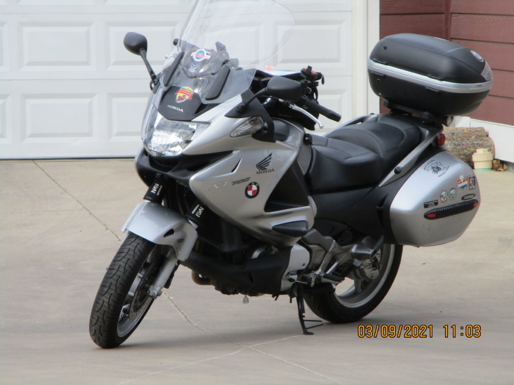

Daler - Out of curiosity, are the scrapes on the upper half from a lay-down? I ask because I'm about to put on the larger Deauville pannier lids and trying to figure out the best location on the lids for some protectors to minimize damage - should a casual drop or lay-down occur.
Aside, great solution - thinking of planning for this eventual failure and keeping straps with me on rides.
With the bigger lids, most of the damage happens along or below the crease line on the panniers. I put rubber bumpers I got from Amazon along that line and (so far) haven't dropped the bike. These are what I got: https://www.amazon.com/gp/product/B07SGDS829/ref=ppx_yo_dt_b_asin_title_o02_s00?ie=UTF8&psc=1
