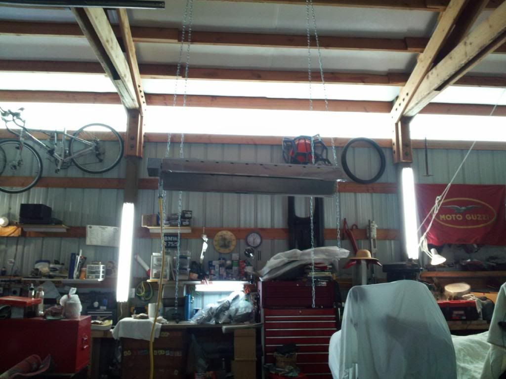

Our garage is 30x60 and currently, the only insulation is on the ceiling. So, when I venture out there to work in the winter, its parka and ski glove time.
however, the spouse moved his shop from one of town to the other and his new shop has a gas forced air unit in it and the two infrared radiant heaters went into storage. I brought one home, rewired it and hung it above my work area.
It will not heat the whole shop (which is fine) but just the area where I'm working.
This is the area that I work in. The spot directly under the heater is where the 'work in progress' bike goes. Eventually, I would like to is bring in the second heater and hang one on each of the trusses. That way, I can stay warm at the bench as well as the bike. The base of the heater is currently about 10' off the ground, not 6' as it is in this pic. :)
(Please ignore the mess, I'm hoping to finish the clean out and re-organize project this year.)
This is what it looks like when its on. Right now, I have it plugged in to the only 220 outlet in the shop. I picked up a new dual pole 220 breaker yesterday and a switch, so I can hard wire it to its own breaker and use the switch to turn on/off, instead of the breaker. What's nice about this heater is that it will only heat up whats under it, so I'm not wasting power heating up the entire garage. What is inconvenient about that, is when I head to the back of the shop to look for something, its stinking COLD and I have to put a jacket on.
This thing puts out a LOT of heat. In fact, I'm going to have to raise it up another 6-8 inches. As I was standing next to the NT, putting the fuel tank back on, the top of my head was getting a little too warm. Bike and tools were a nice 70F. Perfect in that 28F shop.
