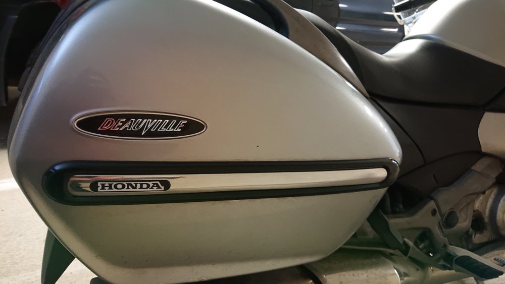

Those pannier guards look great. I could not source then in USA so I ordered them from the brits through EBAY. Delivered cost for 2 was $56.81 us dollars

They look super - I notice a Honda logo on them. What was there original purpose?

I put the "Honda" on there. It's cut from a team graphics sticker sheet, most dealers will have them. The bumper guard comes out of the box with the black oval empty. I'm guessing in some markets the manufacturer has different names they can mold there as needed.

Thanks NewTo700V. Again it looks great.
