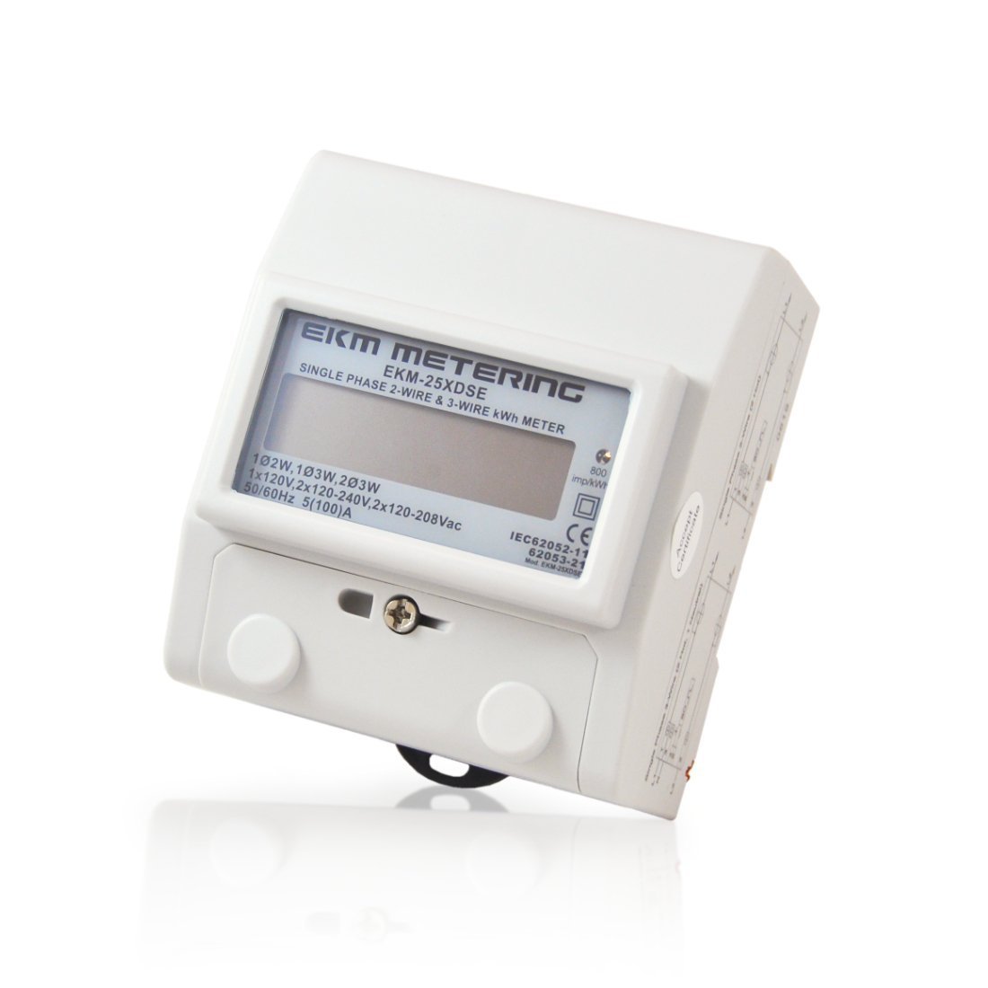

Hi Mike,Something like this would be ideal and only $100!
Single Phase, Pass-Through kWh Meter, 2 or 3-Wire, 120V up to 120/240V, 100A, 50/60Hz, EKM-25XDSE
Universal Basic, Single Phase, Pass Through, kWh Meter –– up to 100A and 13.5mm Wire Diameter. Designed for single phase systems from 120V 2-wire (1 hot, 1 neutral), to 120/240V 3-wire (2 hots, 1 neutral), 100A, 60Hz. Read locally on the LCD display or remotely via pulse output.www.ekmmetering.com
Methinks he suggested it as a sub-meter to log your electricity/costs for charging......the device you shared is designed for use with a Single Phase AC source, operating at a frequency of 60 Hertz (cycles per second). It may not be suitable for the intended application with DC brushless motors.

I was browsing on Amazon for AC Watt Meters and came across this commercially available turn-key unit for under $80.Methinks he suggested it as a sub-meter to log your electricity/costs for charging...

I bought a $30 AC Power/kilo-watt meter from Amazon. To help track my EV Charging kilo-watt usage. I have temporarily wired the unit to the input of my EV Charge Cable. I will be mounting the unit in the watertight enclosure shown in the
