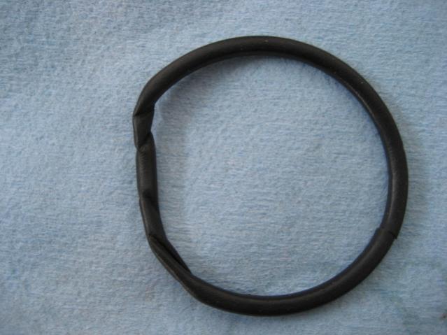

Air Cleaner Housing O-Ring Damage found during Valve Checks
Jun 5, 2011
267
Western Washington
2010 NT700V, 2015 CB500X
Does anyone know of a part number for the O-rings on the bottom of the Air Cleaner Housing that seal to the Throttle Bodies? There doesn't seem to be a part number shown on the NT700 drawings on the Air Cleaner Housing Page or on the Throttle Body page. One of these O-Rings was discovered to be damaged during my 8000 mile Valve Adjust procedure while removed the Air Cleaner Housing. I believe this is the first time the Air Cleaner Housing has been removed, previous owner had from 1700 miles and I don't think he did the 600 mile check. If you have a NT700 Service Manual the O-Ring is shown on the top of page 6-47. Went to the local Honda dealer....no much help there.
The O'ring is close to 2" ID X 1/8" cross section, or 50mm X 3.5mm, not a popular size. I spliced two 1/8" cross section orings to make one that should work fine, but would rather have stock o-ring if possible.

Here are 2 pics of the O-ring from the bottom of the Air Cleaning Housing.

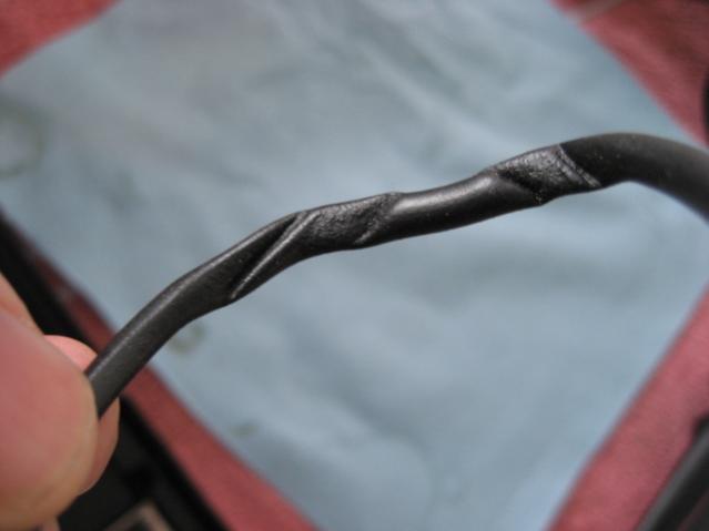

The o-ring is held in by a ID & OD track. ID measures 50mm, OD measures 58mm. The cross section of my damaged o-ring is ~3.5mm, and is ~3.2mm where it was previously compressed. Hard to believe that a 2.4mm swelled up to 3.5 mm.
Really, here are 2 pictures. The O'ring was twisted over once when installed.

My 0-rings should arrive within a week. I have the damaged oring to compare the new oring to, but won't know for sure if either variety fits until 16000 mile valve check. Motorcycle seems to run smoother with the spliced o-ring installed, but the new spark plugs and spark plug caps are probably responsible for it running extra super smooth.
16189-MFF-D00 - O-RING, 51.6X2.4
Finally received o-rings. The Air Cleaner Housing is installed, so this is preliminary review. This o-ring appears to have too small of a cross-section and may not even form a seal.
O-ring, 50.5 x 3.5, 91358-MG9-003 or 004. MG9 is the product code for GL1200 (Gold Wing) 1984-85.
This looks like it should fit nicely. Cross-section is very close to the original and should be fat enough to form a seal. Circumference looks very close. The original o-ring is spongy, and all replacement o-rings are firmer, but I don't see that that would be an issue.
