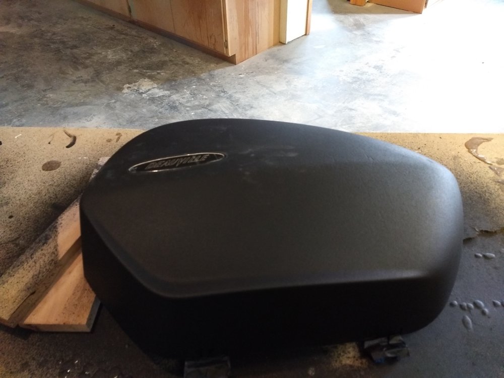

I used the bedliner paint on my lids and like how it turned out.

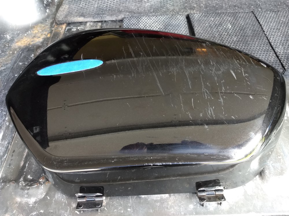

Alright, I am getting my "forum legs" under me and hosted some pictures. Here is what was left of my left side lid after it disintegrated on hwy 60. You can see the plastic bits still attached to the bike:
You can also see my matte black rattle can job on the tupperware. Those will be re-done very soon as my knees have already worn through on those big side covers. I'll try semi-gloss this next time, and add more coats. I'm thinking the rear fender will get the bed liner treatment when I do my miss-matched lids as well.

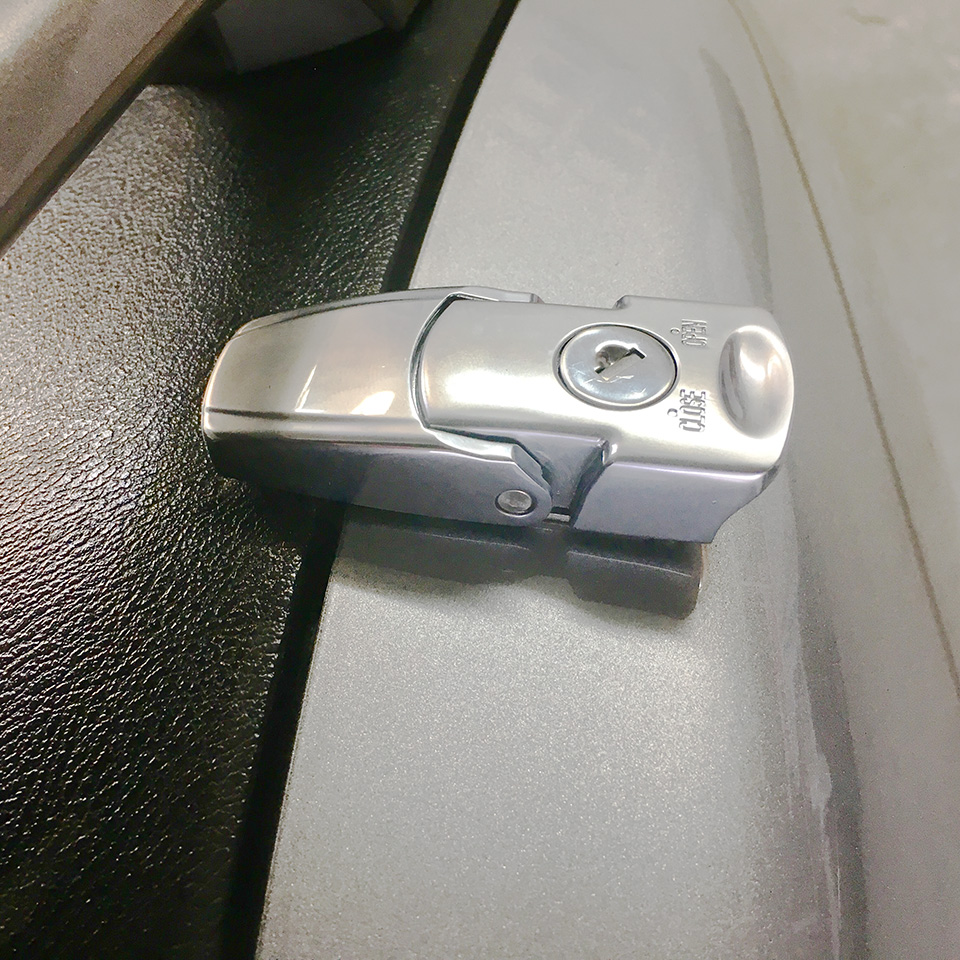

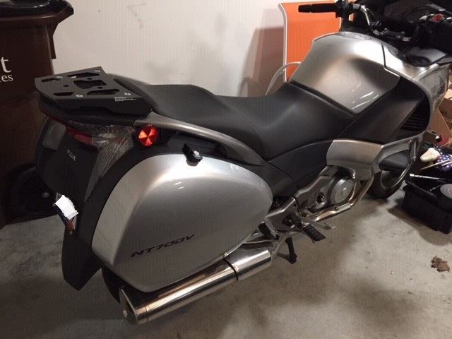

Here's my Southco latches, and SW-Motech rack.
Pardon the american flag back there....one of my little driveway-lining ones for holidays.....it's a torn one that's slated to go to the VFW for burning......

So just one latch will do?
Totally agree on the drag and drop pics...I was digging in my old photobucket this AM hosting pics before I realized.

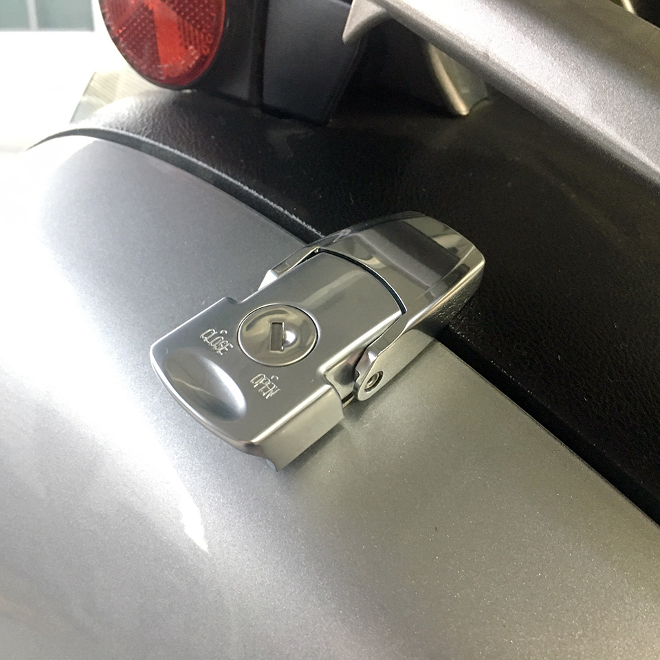

One'll do it, but 2 is fine if you want more confidence. You could do one lockable and one not, or both lockable.

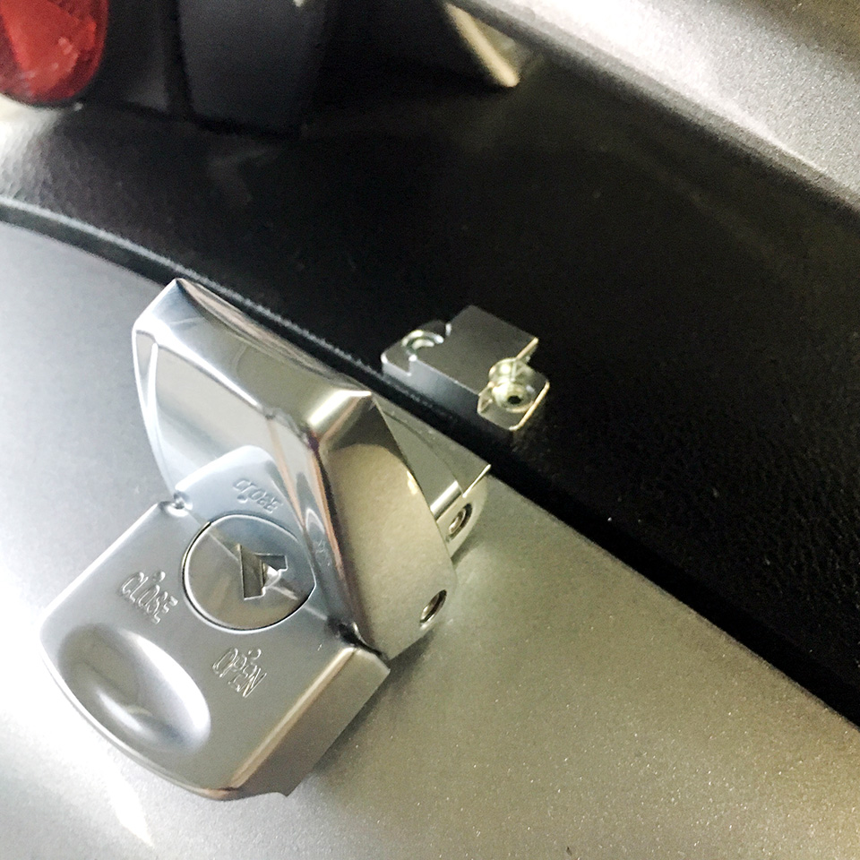

I got mine installed late last season. I actually had it pop open on me on the road -- left side where my registration was, thankfully it didn't blow out! Anyway, somehow on one side I didn't get the catch spacing perfect, and if you push on the lid, you can get the latch to uncatch without unlatching. So I have a slight repositioning of the catch to do. I just say that to say that one will do if mounted properly. :rolleyes:
I have 2 pair, 1 locking, 1 non-locking in each pair. Too many keys for me, I won't be locking them unless I absolutely have to. I keep my insurance and registration in my locking dash cubbie. We'll see what Brillot2000 thinks when I show up at his house. :cool:
Actually, I have to take that back. Due to the fact that the surface is a little curved and not flat, having it key-locked actually keeps the latch from releasing on its own. At least that's my experience, see what Brillot has to say with his similar latches.

With the location that I selected only required some slight tweaking the geometry of the latches to get the locking mechanism to work on my latches. I am not using the Southco latches, its an equivalent.
