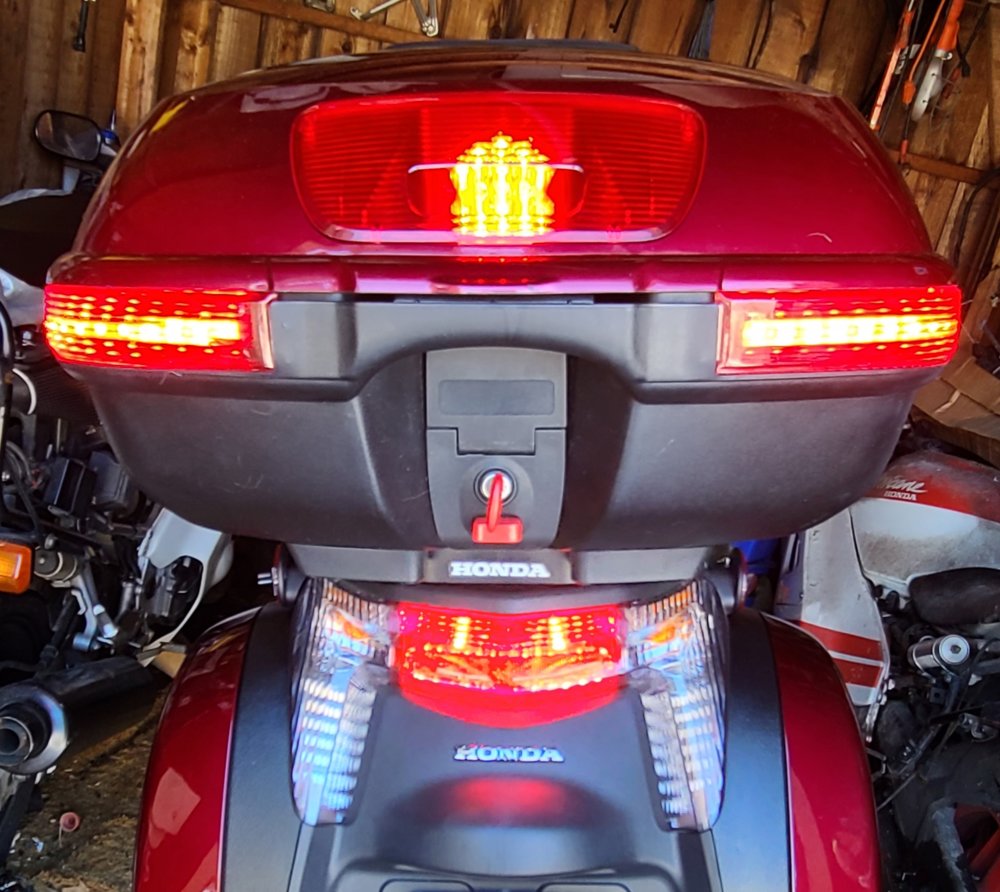

Got a Honda Topbox used for a good price and had just wired my old topbox with lighting so I just had to figure out how to get some lighting on the Honda box. This is what I done I had one led light from the last box so I used it and got another Bestem led wiring harness, only got about $30 in it. Here's some pics what yall think? Updated Part: Got some LED 12" strips Walmart automotive dept for $20 total for topbox lights $50 not bad most kits are over $100. Honda should put lights is topboxes. 2 new pics below.

Thank's Phil I really didn't know if it would show up that well though the
fake Honda plastic lens. I think it will help and it don't look to bad!
I will find out when the weather is better and I can get it on the street at night and give it a look.

Bestem led wiring harness,small 4 pin connector that slides together and a cap that screws it together to keep it water tight. Pic

UPDATE: Added extra brake lighting behind the mid section reflector lens, pic below.

looks cool... and very functional :)
At first I did the top light, I had the ideal from my old box I had wired not to long ago and had the extra led light because they was sold in pairs. It worked pretty good but thought a little more would be even better and I saw a youtube video a guy wired led strip lights on his NC700X Honda box so I went to Walmart and got the same one's he used, here is his video
You've got it lit pretty good. If drivers are awake they will see you.

I used Posi-Tap brand connections for the wiring connections and to tap into the tail light (google Posi-Tap) and Bestem quick disconnect LED wiring harness from Bestem USA.
I used Posi-Tap on mine and they've lasted 8 years and 100,000 miles so far...

Yeah you can find them in the auto lighting section at Walmart they come in colors of red,white,and blue Alpena is the brand name. there 12 inch strips and don't go all the way down the side of the reflector lens there about 3 inches short of that but there work for me you could find longer ones but may cost more and may not be waterproof or as durable?
