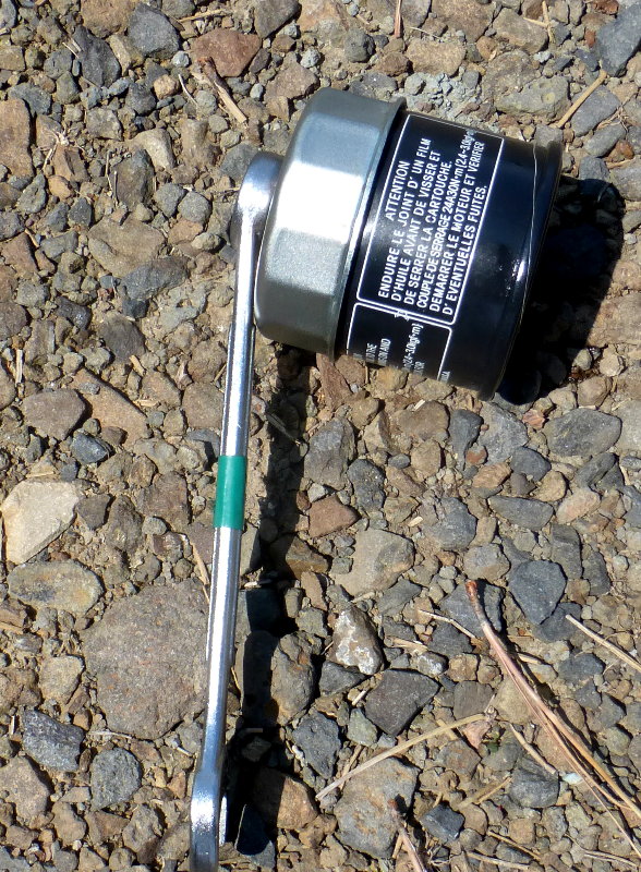

I use a K&N filter, just very easy to remove without the extra tool. KN-204-1 Next time I buy filters I am going to try Hiflofiltro HF204RV. I only change oil at the most twice a year, so paying a little more perhaps does not break me.
Thanks, but that's not MY NT. My NT was made 9/09 and it's the 15 one made in 2010. He didnt say what man. or size of filter wrench he was using but mine is a 14 flat that measures 64.25 mm across opposite flats. I am happy he can get his wrench on the filter on his bike with the centerstand down but I have 1/2 inch clearance between the 2.5 inch filter and lowered centerstand. With the bike on the side stand, I can get the filter wrench on but putting a 8 inch extension through the hole doesnt cut it as the hole is offset from the filter. A wobbly end extension just might do it. Its just easier to use the flat wrench although for getting the torque wrench in there, the wobblyend extension just might work.
(I should say that aftermarket filters are probably fine if they are the correct length but I had a sad experience with a Fram filter so all I use is OEMs. I change filters once a year and I am paranoid doing it that much.

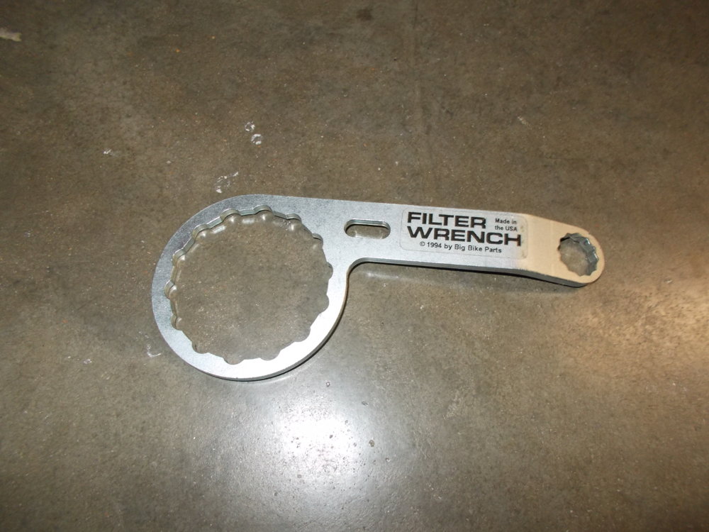

I use a filter wrench like in this picture. There is plenty of room to slide it over the end of the filter and it grips securely. I bought it at my Honda dealer. It would not work to torque it if you want to do that.

+1 to ARKNT's filter wrench. I fought with getting the filter off just once and found that motorcycle filter wrench was the answer. Plus it even includes the drain bolt wrench on the other end! I also use it to tighten the new filter as it offers good torque 'feel'. Amazon has it for $11 and change.
