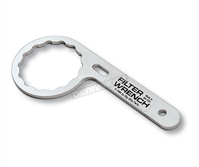

Honda sells the correct short filter and a cap wrench as a kit (FILTER SET, OIL 15010-MCE-H51) or the filter alone. The kit costs about $20 and the filter about $10. You only get 2-3 uses out of the wrench before the hex shears off, though. And why does the hex break, you ask? Because even though I've been changing my own oil for decades and know how tight they're supposed to be, the filter freezes on there and is a total PITA to get off.

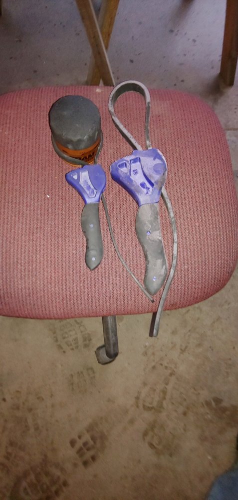

I have two different size filter wrenches that work great. My wife bought them for me years ago, use them all the time! They'll fit any filter too!

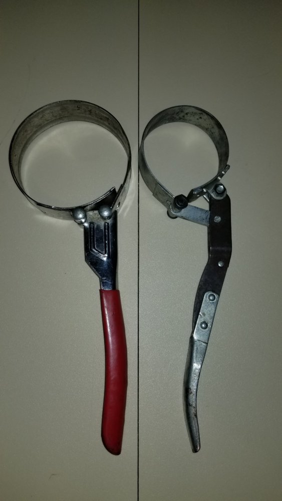

Always used this type filter wrench. I found the small one back when Honda first went to the screw on and it's still working fine for the NT. Actually fit my 4 wheeled vehicle now also. I tighten all screw on filters hand tight and ad just the slightest bit with the tool. Never hard to remove. 14265

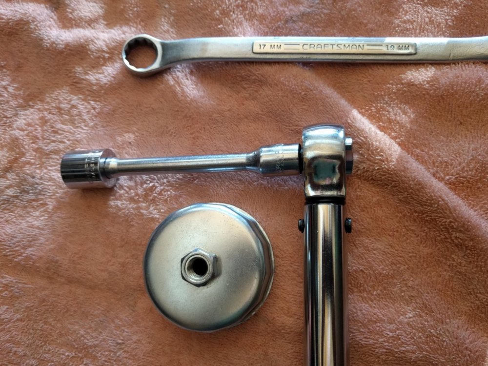

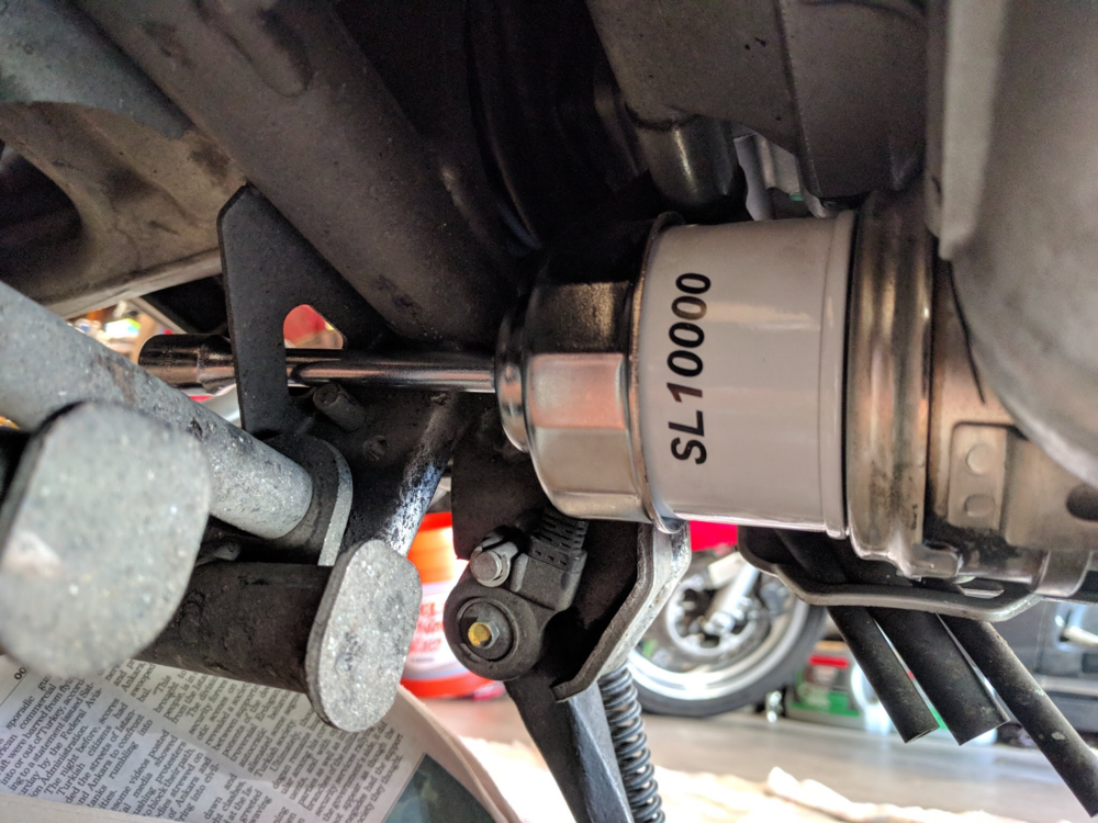

The task was far more simple than I expected.
1. NT on the side stand worked great. 2. I removed the Honda filter easily with a cap-type filter wrench. It has a 17mm nut on top, so a box-end wrench fit perfectly. 3. The Wix filter was found at the O’Reilly closest to home. 4. The Wix filter was slightly smaller than the Honda filter so I used a different cap-type filter wrench that fit it better. The cap-type wrench accepted a 3/8” drive extension. 5. The extension fit neatly thru a triangle-shaped hole below the frame, so after hand tightening I was able to attach a torque wrench below the left side of the NT for further tightening.
BUT.... the filter was already hand tight. I saw no need to torque it to 19 ft.lbs.D53D6436-12AB-4FB4-BB78-5A05FB30C6F4.png7CCFF1E9-6046-4704-9D78-1B96C50858E6.jpeg

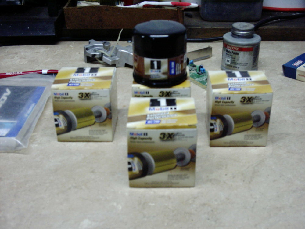

I got 4 M1-108 oil filters brand new in the box that fit the NT perfectly which I don't need anymore and will give away to the 1st 4 people to respond. 1 per customer, please, to spread the love. Just give an address by private reply to send to.
Drain plug - 22lbs
Filter - hand tight
I also have a factory owners manual excellent condition to give.
